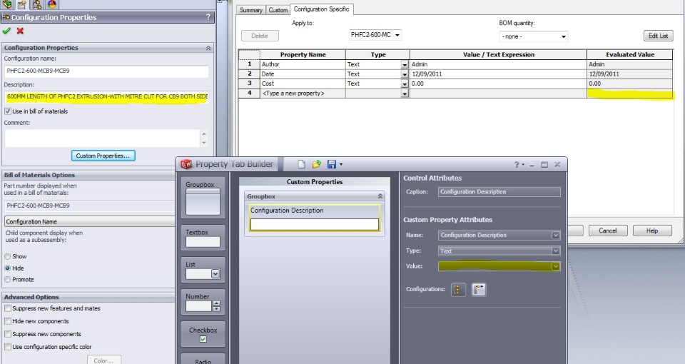

Hey all,
I'm trying to create a reference in the property tab builder or configuration specific properties that can read the configuration description for both parts and assemblies. I was just wondering if anyone had found the correct variable for referencing that?
I know it is SWCfgProperty-Description in EPDM land, but i'm trying to figure out how to reference that without having to manually copy and paste the values.
So brace yourself for some amazing screen shots
Thanks everyone

I've also been looking for a way to do this. No luck so far. Anyone else?
SC
SC 2015-03-02
I also believe this would be beneficial to have done as well. I'm on 2015 and this item has not been resolved.
I have spoken directly with 3ds in a meeting directly and established that this an item to be looked into.
