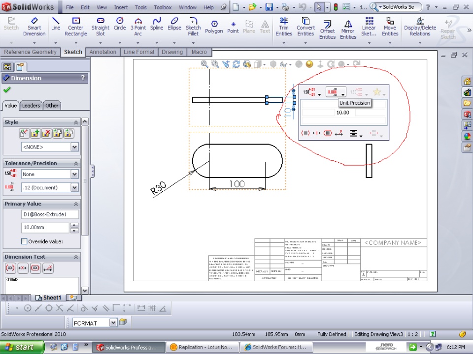

Can we turn-off this pop-up?
pls find attach image
What service pack ar you at? Upgrade to 4.0.
Upgrade to SP 4.0 and this dimension pallete will not popup anymore.
It will be more controlled as an "X" near the dimension that if you click on it
will show the pallette.
Much better then what you are experiencing. Trust me!!!
