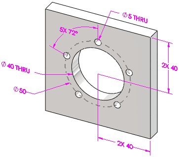

I am trying to create the polar pattern dimensioning in DimXpert similar to this image I found in Solidworks help.  My question is:
Does anyone know how to create an angular dimemsion, in DimXpert, between two holes (as shown in the attached image)?   Also, how do you dimension the diameter of the pattern holes (the 50mm diameter dimension)?  Any help would be greatly appreciated.  Thanks.

Pretty straightforward. Create your holes as a circular pattern and add center marks as a circular type. You can then dimension to the center marks. Click on two and it will add the angle. Click on the circle the center marks create and it will dimension it as a radius which you can change to a diameter. Use the hole call out to dimension the holes.

Thanks for the response.  We you able to create these center marks in DimXpert or on the drawing?  I am trying to figure out how to do this in DimXpert.  I would like to apply all the dimensioning and GD&T in DimXpert and then using the TolAnalyst to perform a stack-up.

The SolidWorks Help goes through it somewhat, but here are some instructions to use DimXpert in parts:
1) Go to the DimXpert Ribbon tab in the Feature Tree area or the Command manager
2) Select 'Auto Dimension Scheme'
3) Within the settings, change it to 'Polar' and set the minimum number of holes to recognize (this can be left at 3)
4) Select at least 1 datum
5) In the 'Scope' group box, simply do all features, or 'selected features' and then choose one of the patterned holes, making sure it lists the 'hole pattern'.  If it does not, then in the little flyout menu, change it from 'simple hole' to 'pattern'
Note: it shows yellow then because it is showing the 'Show Tolerance Status'.  You can simple click this button off/on to see if it is fully constrained or simple hit the 'Esc' key.
Hope this helps.

That worked perfectly.  Thanks for the help.
