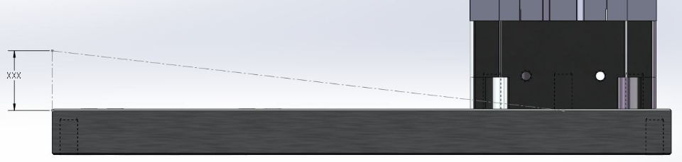

Hey Everyone,
I am trying to find out how to do the point to point in tolanalyst. I have all the parts fully dimensioned with GD&T( and Dimensions. I want to see how far the fluctuation between 2 points can go (See Image Below). I have tried the obvious stuff, but for some reason it will not  give me a dimension. Can TolAnalyst take GD&T (Parallel, Flatness, and perpedicularity) and Dimensions into account? I thought I had everything set correctly. Anything obvious I may be doing wrong or can solidworks even have a complex problem like this? It just does not seem able to take a lot of complex GD&T into Account

Are the parts dimensioned with the dimexpert tool? that is the only thing the tolanalyst will work from - not regular model dims and notes. that is the main reason I haven't used the tolanalyst. I just can't stand to dimension the parts twice.

Jeremy,
Yeah they are fully dimensioned in DimXpert. GD&T and Dimensions w/Tolerances. From other posts it looks like it can't handle that complex of problems. I agree that it is a pain and super time consuming to dimension the parts twice. You can also select points when running it, and it works for real easy problems, but for this one it just says 0. I am guessing that is just can't handle it
