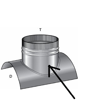

I would like to design Plenum Spigot which is fixed with cylindrical duct. As per picture below (ignore grooves, swages)
The cylindrical shape of that spigot needs to overlap to allow for spot welding, also we need a flange to connect circular duct with spigot. All I came up with is attached. Of course it has to be flatten after all to send it down to laser cutting machine.
Any ideas?

I do similar parts by adding weld tabs around the cutout to part "D".  Fold the tabs up by hand and weld to ID of "T"  That is of course if the Diameter of "T" will allow access to spot weld

Well of course that works but I would like to copy our manufacturing method to solidworks. Which of course have a flange on Spigot and round hole in plenum/duct.

For sure you are not going to be able to do this with the SW sheet metal tools and get it to flatten. You can model it traditionally using the surfacing tools and if you have "premium" available to you try the surface flatten. I did try it but didn't quite get the results I had hoped for. Think if I had put more effort into it and split it up a bit, probably could have come up with something decent. You could just sweep the ring (without the flange) unfold it and offset the scalloped area ?? amount for a flat pattern. It would be interesting to know your manufacturing method for this but I can imagine it. Sure looks nice in your pic.. I suspect that is an off-the-shelf item but doesn't suit your needs (done with tubing?). I left the beads out of my model but you already are an expert at that...
