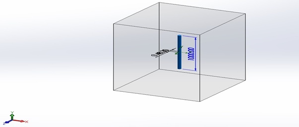

Please Find out the Drag Coefficient for a simple vertical cylinder as per given data below. I was trying to get results as per IS 875 standard. Please go through it and let know the procedure for it.
This is the procedure I followed to find out the Drag coefficient of cylinder, but the values are showing wrong. please run a test on it and share your knowledge with me.
Size: Dia 48.3x1000 mm.
Wind Velocity in X Direction = 47M/S
Input Data: General Settings
Analysis type – External
Fluids: AIR (Gases)
Flow type: Turbulent
Thermodynamic Parameters:
Parameters - Pressure, Density
Pressure- 1325 Pa
Density 1.2kg/m^3
Velocity Parameters:
Velocity in X Direction: 47 m/s
Velocity in Y Direction: 0 m/s
Velocity in Z Direction: 0 m/s
Computational Domain Size:
X, -X
Y, -Y
Z, -Z
Study1 0.6, -6m
1.0, -1.0 m
0.6, -0.6 m
Study2 0.8, -0.8m
1.0, -1.0m
0.8, -0.8 m
Study3 1.0, -1.0
1.0, -1.0m
1.0, -1.0 m
Study4 1.2, -1.2
1.0, -1.0m
1.2, -1.2 m
Goals:
Applied Equation:
({GG Force (X) 1} *2)/ (1.2*47^2*3.14*0.5*.0483*1.0)
({SG Force (X) 1} *2)/ (1.2*47^2*3.14*0.5*.0483*1.0)
Standard Values:  Cft – 1.0 (Dvd <6) Cft is the required result as per standard.
(Standard Values Reference from IS 875 Part 3 Link mentioned below)
 IS 875 Link (https://archive.org/details/gov.law.is.875.3.1987) Page no:40 Table no: 23
Achieved Values:
Global Goal
Surface goal
         Cf Value
Average
Cf Value
Average
Study1 0.88
0.87
0.88
0.87
Study2 0.88
0.87
0.88
0.87
Study3 0.89
0.88
0.89
0.88
Study4 0.89
0.88
0.89
0.88
