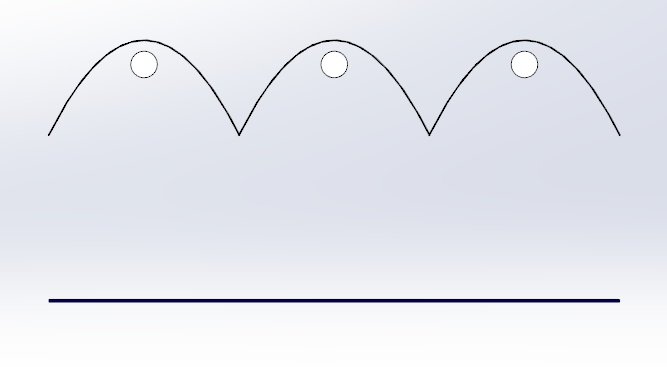

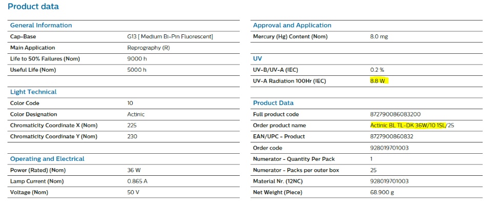

I'm at a really early design stage and have still to work out the optimal sheet size, but I think I've found a suitable lamp that's about 600mm long, so I'm working from there.
The datasheet for the photocoat we are using mentions an exposure distance of 250 to 300 mm.
So I just drew a parabola and threw in a few dimensions and this is what I got
So conceivably this could expose a sheet about 300 wide, but will it give an even exposure?

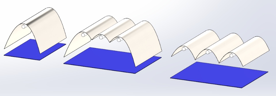

If I'd like to go wider (A square sheet 600 x 600) my options could be to add more lamps, move the lamp or sheet during exposure or multiple exposures.
Anyway just playing around here's what I've come up with so far
Did I mention I'm on a tight budget?
Anyway advice from someone who actually knows about these things would be greatly appreciated.
For example , these reflectors look a bit wrong to me
Maybe I'm overthinking it but I know good results require a consistent exposure and it would be great if I could get this right first time.
