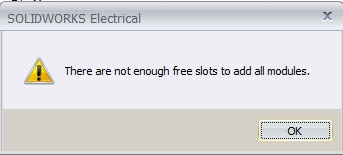

I created PLC2 as a test, thinking that maybe there HAD to be a rack associated in order to make things work. Except I can't really test that, because I get the following when I try to add more than one module to a rack:
I've checked everywhere I can think of and I can't find anything that will allow me to define how many slots a rack should have.
So I guess the question is two-fold: Is there something I screwed up in adding the modules to the PLC without a rack, something that's making me unable to put them in the proper order? And is there a way to define how many slots the rack should have (good to know for the future, I do a lot of work with controllogix as well)?
