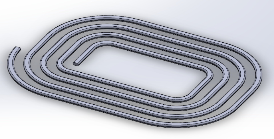

I'm trying to build a 3D model of for a planar transformer winding that looks like the following image.

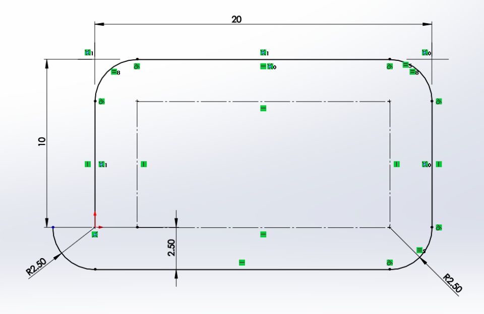

As a first step I draw the elementary turn along which the wire will be swiped.
From there the function "offset entities" is super useful, however strangely it cannot be repeated N times so that to directly get the desired number of turns.

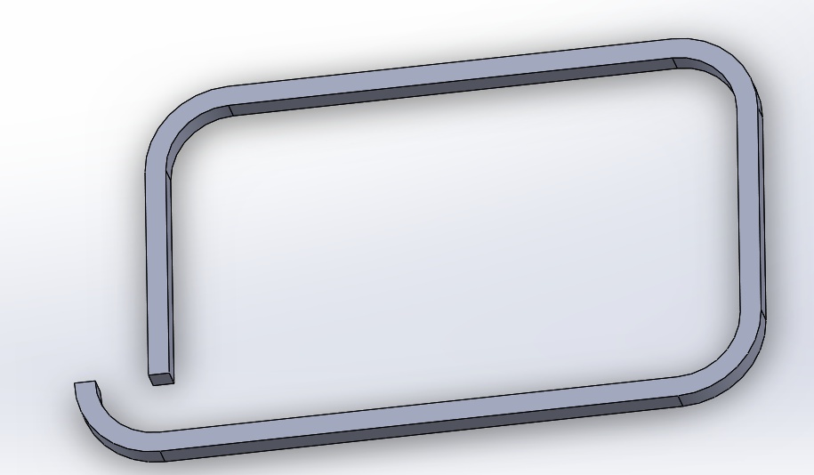

Then the wire is swiped along that line, leading to the image below
Once again it leads to frustration as no function to duplicate that geometry to construct a planar winding is available.

My objective from the result would be to parametrize the elementary turn and then be able to set the number of turns. Any good recommendations?

I'm not aware of a builtin tool to repeatedly offset entities. My naive approach would be to write macro that offset entities "N" times on the currently selected entities (growing outwards).
The first problem would be figuring out which entities need the offset performed for N>1 as you would need to select the newly created sketch entities to perform the second, third, ...nth offset.
One of the options will turn the "base" entities to construction geometry while the new entities are not. You could use this criteria to filter your selection for each successive offset that is performed by the macro.
Alternatively, you can re-select the original entities and perform the offset with d_N = N*d_0 where d_0 was the original displacement.
