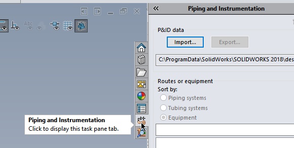

Now this entire database is used according to the help file for:
"The Piping and Tubing Database contains piping and tubing part configurations. You can filter or modify configurations in the database to streamline component selection when you create Routing assemblies from incomplete P&ID data."
In short, if you actual use the tab as displayed in the above screenshot. Doesn't look familiar? I'm not surprised.
