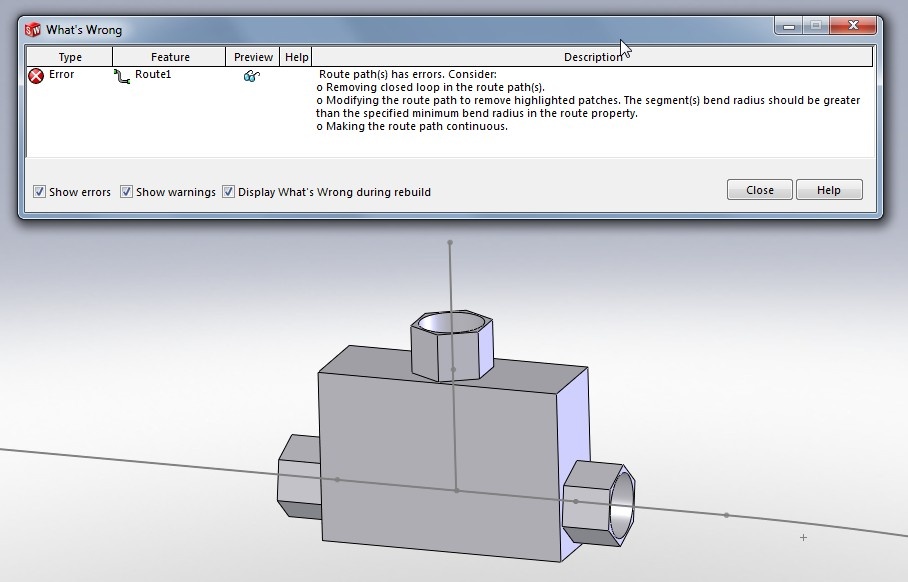

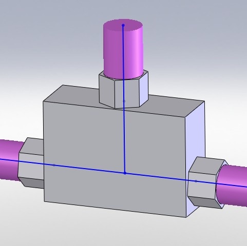

I'm new to SW 2010 and Routing and have an problem with my pipes disappearing after I exit sketcher after I've added a tee that I've made.
SW rebuilds the pipe and puts it into the Route parts list but there is just a line on the screen.
What is the problem?

Does it only happen with this part? Can you post this part? Can you post a screenshot of your routing options from system options?

It appeared that the problem was with in the definition of the Cpoints.  I fiddled around with it for a long time and in the end it worked but I don't know exactly what I did to fix it.
I ran it through the component checker and it had all the requirements. That may have helped because it said at the end that it'll add the Cpoints.
I don't know if the Checker does something to the file either.
I did also have some issues in the Design table section where SW would multiple 1 column of numbers by 1000 fo no apparant reason.

Ok pipe is dissapearing again but with a 1" this time.
How do I add a attachment?
