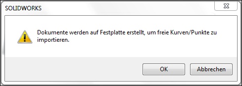

Currently I am trying automate the process of importing a geometry (located in a .step-file) into Solidworks, setting a camera angle and export a picture of the geometry. Unfortunately the import of the geomery gives me a warning message which says 'documents will be created on the disc to import free curves'. Two options are given: 'OK' and 'Cancel' (please use the picture as reference).
I always want to pick 'OK'. Now I am looking for a command that can be used inside a macro to avoid this message or to pick 'OK'.
