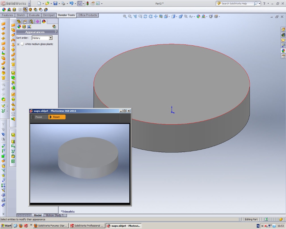

When I apply a material in Solidworks (2011 SP2.0) and open the Photoview Preview Window, the color appears slightly darker than should be. When opening the feature manager of the applied material, you can see the color in the Preview Window update to it's correct value. When closing Photoview and reopening the Preview Window,  colour is darkened again.
material white medium gloss plastic applied, then opened Preview Window. Material shows too dark:

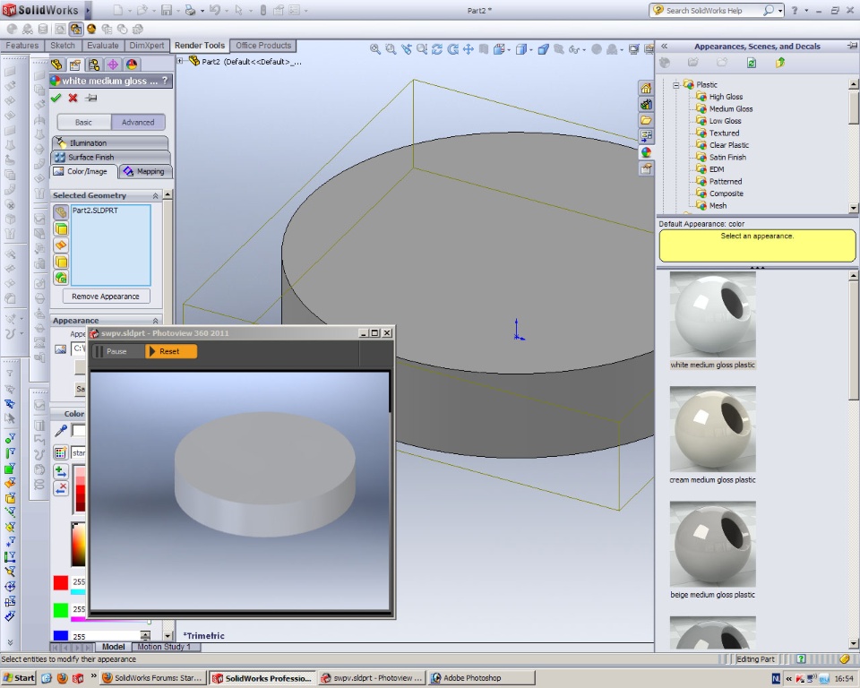

On reopening material, it shows up correctly (brighter) in Preview Window:
