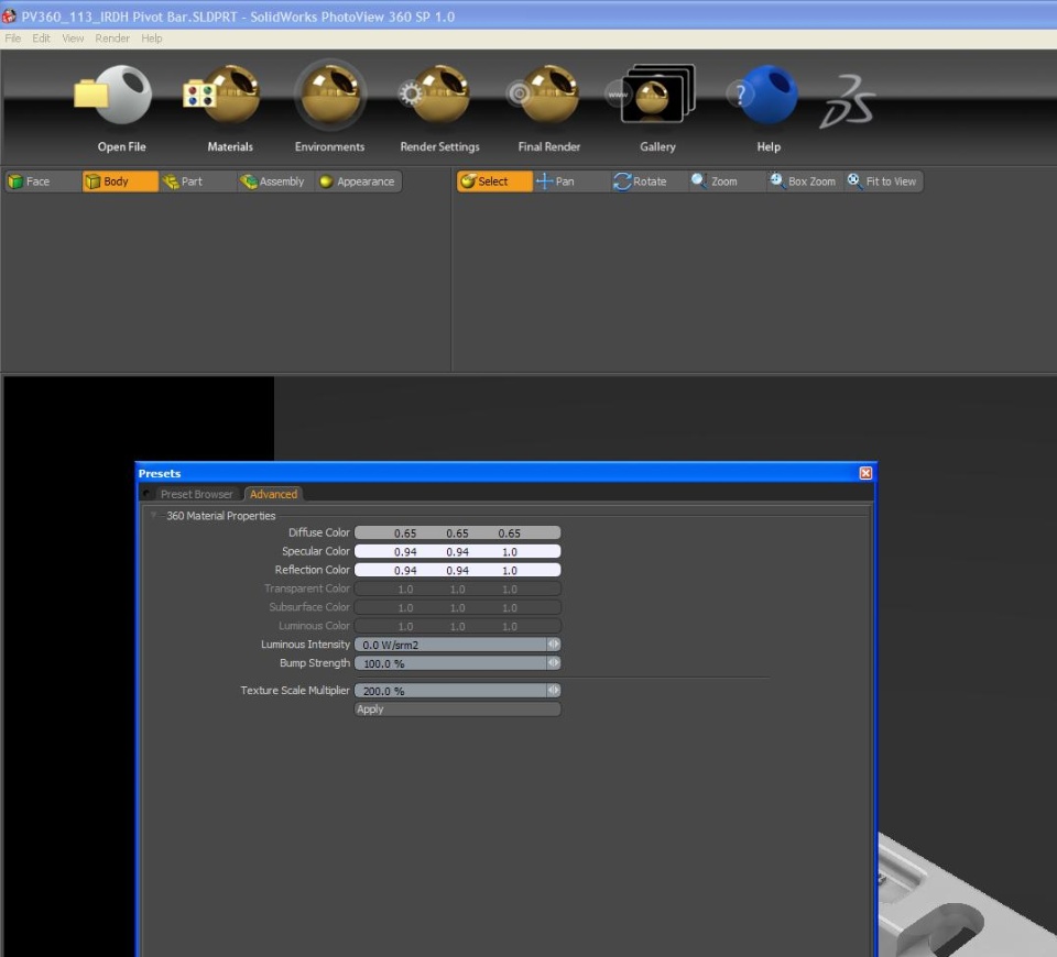

I'm having some issues with my interface in PhotoView 360.Somehow I lost everything from the Materials advanced tab. It isblank until I click on a part, then I only get the properties (seeimage), with no color chooser area above. This happened in themiddle of making some adjustments. I think I hit some keysaccidentally, but I don't know which ones.
The screenshot also illustrates another annoyance. Notice that Ihave about 1-1/2" of blank grey between the image area and themenus. I cannot get rid of that. If I try to drag the top edge ofthe graphics area, only the sphere images at the top get smaller.

That's really odd....your config has changed.
SWPV360.cfg (should be in user/application data/luxology..)
Restart 360 and you should have your default layout back.

and yes i also thought that i had inadvertently hit some button. iguess not.
