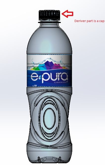

Hi every one.
todey I see an error in photoview.
when I do a render of a file containing a derived part. the Photoview apply scale in the derived part!
look the pictures
solidworks part
Photoview preview
photoview finish
SolidworksPhotoview 360

the cover is a derived part with 2 restrictions.
1 - concentric to the finish of the bottle
2.- touch in the finish lip
