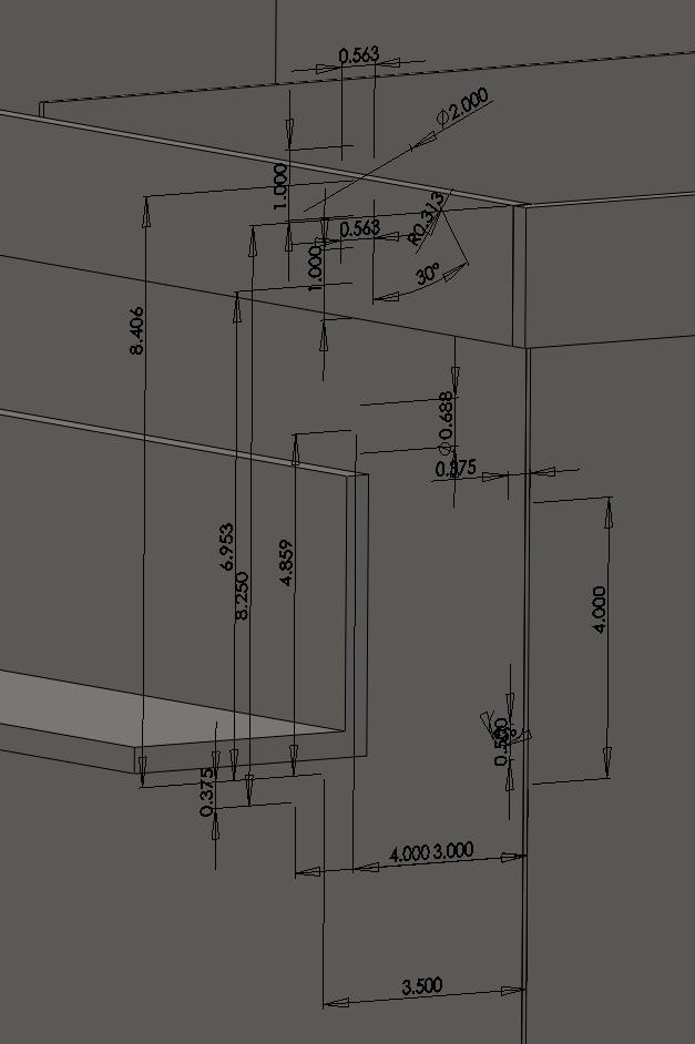

When I drop a particular part in an assembly there are somedimensions that keep showing up from one of the sketches in thepart. (See attached.) These dimensions aren't selectable and Ican't figure out how to hide them.
Thanks,
Dave

JM 2009-01-29 Best Answer
Make sure you have 'show feature dimensions' turned off inthe part.
SF 2009-01-29
Thanks Jeff. I'd never run into that before.
