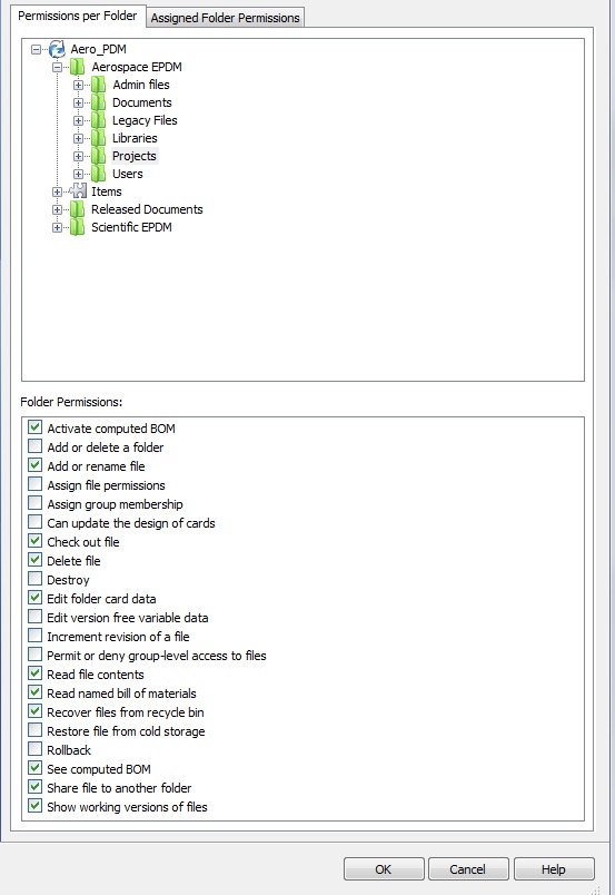

In the Solidworks help file, there is a section that shows how to allow groups with the given permission to see files that have not yet been checked in by other users, but are in their local cache. When I follow the instructions to set this up, referring to step 5 below, "May see files before initial check in (Private State) is not there at all. Am I missing something? I have included an image of one of my groups showing that this is not where the instructions say it should be.
I think this would be a great permission to give just to the engineering group so we can see files a colleague is working on even before they are checked into the vault.

TW 2014-11-15 Best Answer
Hi Lawrence,
This is a feature in 2015. What version of EPDM do you have installed?
TIm
LK
LK 2014-11-15
Tim,
Thanks for the reply. I thought this might be why Its not available to me. I am on 2014 still.
