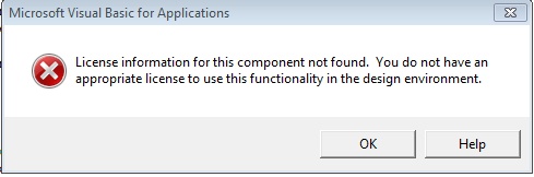

I am getting an error while running a MS Excel based Workgroup PDM VBA macro, which is to get the list of files stored in Workgroup PDM. This was working till last week, until we switched from SolidWorks 2015 to SolidWorks 2016.
The API at which is failing is while creating a connection object, Set connection = CreateObject("PDMWorks.PDMWConnection"). I get the below error message.
When printing the Err.Number and Err.Description, it results in 429 & "ActiveX component can't create object".

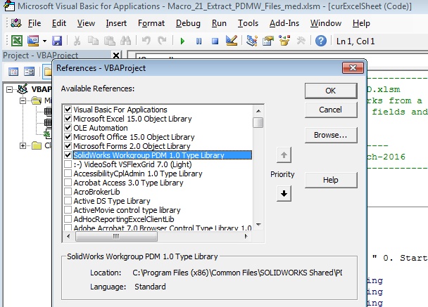

I think I have the correct libraries imported, as below.
