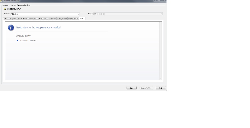

The PDM Workgroup view tab is displaying error message "Navigation to the wenpage was canceled". Right-clicking the drawing and selecting "Document Information...", then selecting the "View" tab are the steps to reproduce, repeatable, on my machine.
Workgroup PDM Options / Folders has default save folder on my c-drive and the temporary viewing files folder also on my c-drive, two different folders with the viewer files in a folder named "viewer" under the pdm workgroup file location for the default save in folder for open and check out.
Anyone have any ideas? I'm currently fishing for solutions and trying different approaches to resolve, but so far, no luck. Screen capture attached.

Do you have edrawings installed on the system? That is what PDMW uses to view the files. Also, verify that the PDM/SWorks/Edrawings are all the same major versions (all SW2013, Sw2014, etc).
SF
SF 2013-11-26
I knew all PDM/SWorks/Edrawings were all the same major versions, but went to check anyway, based upon your feedback. What I discovered when I went to Help/About Solidworks PDM Workgroup, is that the 'update' button was 'active' or highlighted b/c and update was required for the PDM Workgroup. Once I did that update, I received a message that the PDM Workgroup was compatible with the Solidworks. So, I guess SW did an auto-update and the PDM vault was a manual update to follow suit? IDK, but it's working again. Thanks for helping! Much appreciated.
