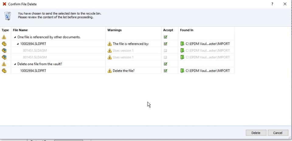

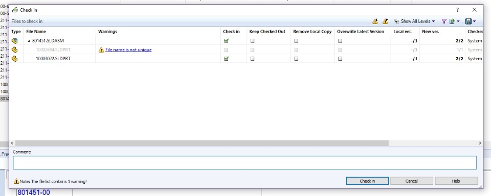

So, I have an assembly that I did a Pack and Go to bring into PDM Professional 2017. One of the components already resides in PDM When I check the assembly and associated files into PDM I get the check in popup as expected saying the parts that will be checked in and the file that says "File Name Is Not Unique". I checked in the assembly and component that is not new and in the folder, I deleted the non-unique part. I get the popup as expected stating it is referenced by the assembly.

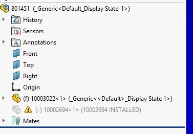

After checking out the assembly and the newly added component, I go to Tools/Update References. When I do this, the only thing showing is the assembly and the newly added component. The component I deleted doesn't show so I can replace it. It should show with the warning "File Not Found". I can't click Replace File because there is nothing showing to replace.
If I open the assembly, I get prompted to browse to find the component so the component is still showing in the assembly. Is there a setting in Administrator that I'm missing or something else?
