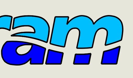

This photo (below) is a screenshot of the logo on a drawing. Each colour is a separate block with a separate layer. Colour_1, Colour_2, Outline. The outline is on a thicker linetype layer.

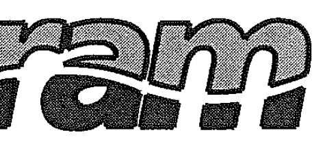

This photo (below) is a scan of drawing logo when the drawing is saved as a PDF, and the pdf is printed. It appears the linetype thickness did not commute on the outline.
This photo (below) is a scan of drawing logo when printed from Solidworks (no conversion to pdf). The linetype thickness commuted properly.
It appears to me that on the PDF of the logo, the hatching is placed "in front" of the ouline, partially eclipsing the line, making it seem thinner. For whatever reason, this doesn't happen with the print.
Does anyone know how to make the PDF look like the direct-print? Is there any way to "plot" to a pdf instead of saving to a pdf?

<p>Sean Sotola wrote:</p><p></p><p></p><p> Is there any way to "plot" to a pdf instead of saving to a pdf?</p><p></p>
Yes, printing to PDF will often give better results if saving to PDF isn't working properly.  If you don't have Adobe, so that PDF shows up in the drop-down where you select the printer in the print properties dialog box, you will need to get a PDF printer.  CutePDF is a free one that I've seen other people here recommend, but I don't have any personal experience with it.
