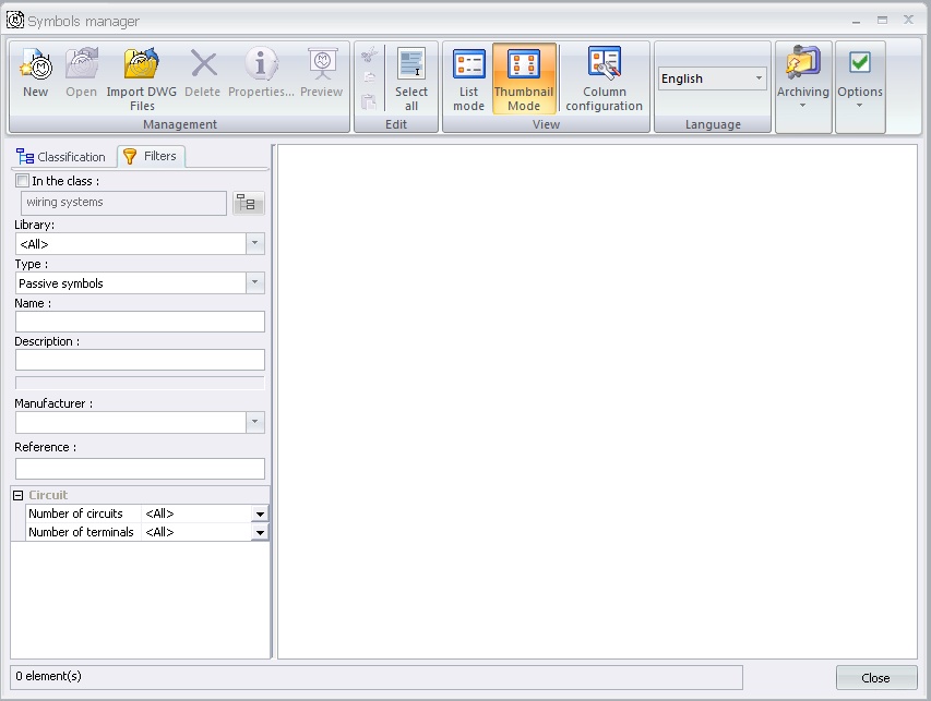

Have you tried going to Library -> Symbols Manager
Then click on the Filters tab and under "type" choose "Passive Symbols" - I am on 2014 SP02 and there are 6 symbols in my library based on that filter and the initial install.

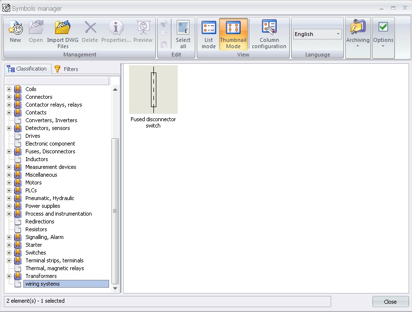

Finally got SP2, still no symbols.
The only thing under "Wiring Systems" is "Fused disconnector dwitch".
