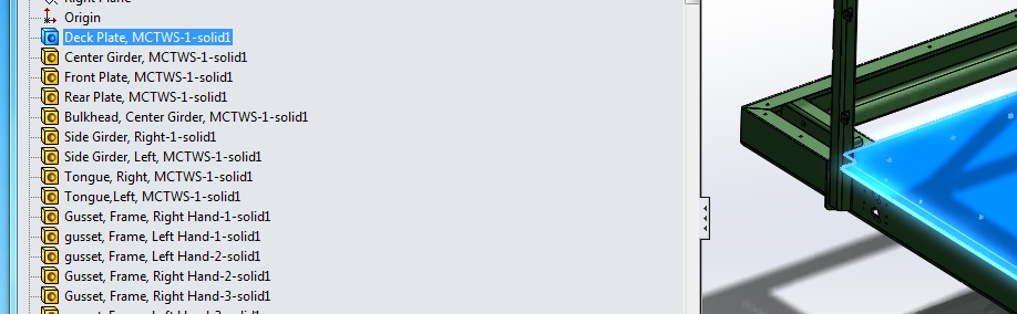

All,
I am a newbie. What are these parts in tree? See attached. They do not open as a part file? Can they be added to a drawing to detail each part?
Thanks,
Wayne

This is an imported file and seems assembly as saved with option to have all files in one single file.
These are components files showing as imported bodies. Yes then can be added to drawing for detailing. If you want to separate them quickly then check this. Assembly from Part – No mates required

Yeah - this would seem to be so Deepak. I don't know why. The files from months ago were sent as parts. Must have been purposely saved that way. I am just looking to make quick 2d drawing views to thro into acad. I am using configurations to break down parts on a sheet. Thanks! Wayne

<p>Wayne Falco wrote:</p><p></p><p>I am using configurations to break down parts on a sheet. Thanks! Wayne</p>
You don't need that in case you want to show views of each body (as individual part). Simply use relative model view.

I'm going have to digest all this at a later date. So far configs are working fine and don't take too long to do. Thanks again!
