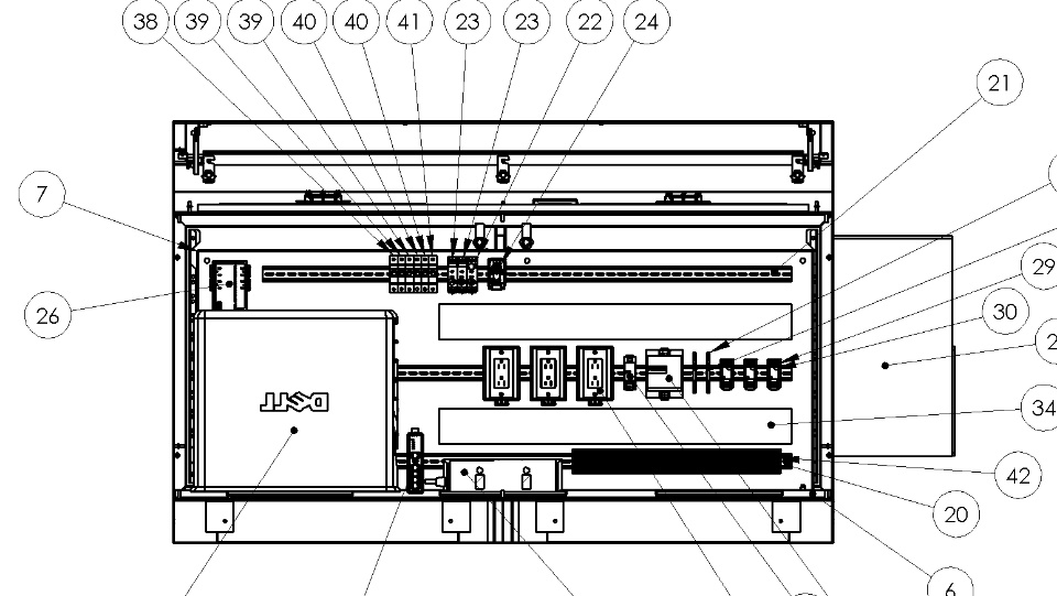

Morning,

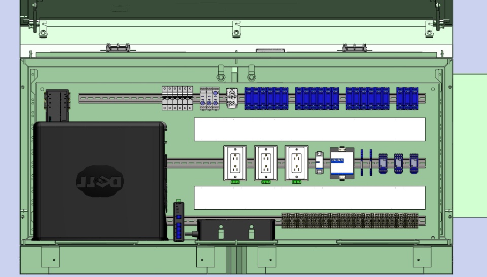

I'm working on a section view of a control console, and when I do a cut away view to show all the goodies inside, some of the parts just don't show up (drawing.jpg, attached).  If I slowly run my mouse over the area I can see the edges highlight orange, and I can able to put the balloon on the first of the blue modules shown in the model.jpg picture, but I can't seem to make the parts show up to save my life.  Is this just me running into a limit on my graphics card, or is there something up?  Thanks in advance; hope everyone had a great Thanksgiving day weekend.

SM 2011-11-28 Best Answer
Damon,
Try RCing on the cutaway view in the feature manager and select modify view.
Then go to the section scope and remove these components from the section view.
This will allow these components to be unefected by the cut away.
SF

I don't know if it makes a difference, but I'm rockin' SW 2010.  I tried excluding them from the section, and I tried changing my view to all the options (from wireframe to shaded with edges) and no dice.  Could it make a difference that all but the first instance is a linear pattern?  But if that's the case, then why would the terminal blocks on the bottom show up...

Also, I don't know if it makes a difference, but I didn't use a broken out section, I used a partial section view.

You may want to try using an ordinary view and choosing to hide the parts you dont want to see from the propety manager.
SM
SM 2011-11-28
Same functionality was in 2010.
You can still use the section scope in the partial section view as well.
Make sure your section cut is not beyond the components you need.
Did you try moving the section cut back?
You might want to try and use a broken out section view and see if that gives you what you are looking for.
Just create a projected view and draw a spline where you want the cut to be.
DF
DF 2011-11-28
I tried moving the section line back (it was already well cleaer of the signal conditioners though), and futsing with teh section cope to no avail.  I just made a configuration with the panel doors removed and called it good.  Thanks for your help everyone.

SF 2013-08-07
Damon,
I've had this problem happen a lot.  What I found is the objects that did not show up in my section view were created as surfaces and not solids.  Therefore in the PropertyManager, I selected the "Display surface bodies" check box under  the Section View menu.
