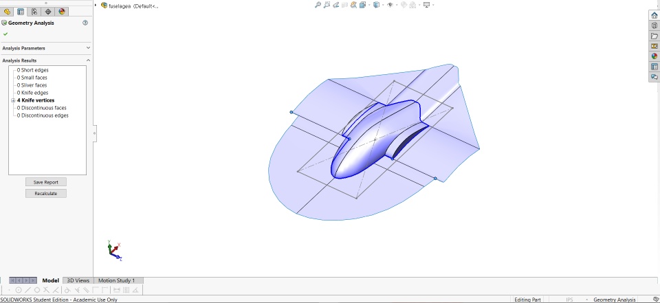

Hi all,
I've been working on a mold for a part for quite a while and I've been stuck since it keeps giving me the same rebuild error (cant knit sheets) when I try to make the tooling split. I've made some molds before but I have never run into this problem and I would appreciate some help. I just cant see why it would be giving me this error since I've done a geometry analysis and it shows nothing that would need to be knitted and just 4 knife vertices.
The mold will be used for a composite layup and neither the top nor bottom of it work so I've attached the part in multiple formats below and I would appreciate tips or help because I really don't want to use the cavity tool in an assembly since I believe it would be too complex with the geometry I have.

I have found that the mold tool functions can not work on complex geometry, especially parting surfaces.
A good work around (which I personally prefer to mold tools anyway) is to use the already created core and cavity surfaces. Take a copy of the parting surface so there is 2. Use the knit command to knit the cavity surface to the parting surface, do the same with the core and the copied parting surface.
Now we can create planes for both halves of the tool and simply extrude up to the knitted surfaces we have created.

I agree with you ​. It is interesting in this case that the Parting surface will not knit completely with the Core surface.
There is a gap in the red area witch can not be handled by Gap Control. Is the part 100% symmetrical? Anyway you will have to tweek the Parting surface to get good results.

Please see image of my attempt. I have had to use a combination of delete faces and surface fills.

The part is 100% symmetrical (created using a mirror) and I spent a good hour and a half using the manual option with the parting surface to no avail. Apparently complex geometry like this is not possible to mold using default tools.

The Parting Surface tool in Solidworks is nothing more than ONE of the many surface creation tool at your disposal in Solidworks.  Don't get stuck thinking that it is the ONLY option at your disposal...it isn't.
Extrude
Sweep
Loft
Boundary
Planer
Ruled
Radiate
Familiarize yourself with the full suite of surface creation tools.  Especially Boundary & Ruled, they are 2 of the most useful tools for creating parting surfaces.
