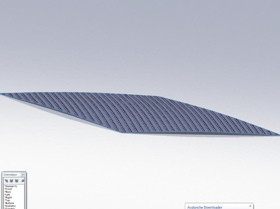

Looking for help and/or suggestions. I'm trying to populated the rotated surface of the attached file with partial sphere's.(domes) The height above the ruled surface needs to be .004" with a radius of approximately .030". I'm pretty sure a grid pattern of .0375" centers will work. I've never attempted anything like this.
I now attached another file trying to explain what I am trying to achieve. In this new file, single_0375x0375< I would like to copy this in  all directions along the 8.396" radius. I would like it also to be a single surface.

There is only one way that I know how to do this and that is using the deform feature after area pattern. See attached.  (unsuppress the pattern feature - I suppressed it for file size upload.)
Regards
Mark

If you are trying to pattern across a revolved feature, use a Circular Pattern with the Axis at the center of the revolved face to pattern in one direction. Then pattern the first Circular Pattern with another Circular Pattern using an Axis normal to the first Axis. This is simpler to do in solid because you can pattern a feature as opposed to individual bodies. Delete Face turns it into a surface.
If the surface was not revolved you could insert Face Curves onto the surface (Tools > Sketch Tools > Face Curves), then use those 3D Sketches for a Curve Driven body pattern. Alternatively start another 3D Sketch, place points on the intersections of the Face Curve 3D Sketches and then use a Sketch Pattern to pattern the bodies.
