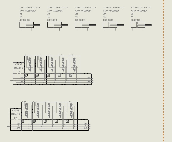

Does anyone know why sketches in a part file would show in an assembly drawing (I want to see this sketch) when the drawing was first created but not show in additional instances that were added to the assembly after the drawing was created. they will show if I make a new drawing
Original Drawing
Additional parts added to assembly
New drawing created shows all sketches

sketch visibility in drawing views is not dynamic - i.e. it does not automatically update.
you can right click on the view and select "reset sketch visibility" - that should get your sketches to show in previously created views.
AS
AS 2017-07-21
Well that does show the sketches. Its better then making a new drawing. I'm guessing there is no way to make it dynamic then?
JF
JF 2017-07-21
none that I am aware of.
