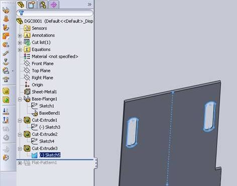

Question #1 - What is the difference between the icon befor Sketch4 and Sketch5
Question #2 - If I want to change the dimensions of Sketch4, I simply double click on "Sketch4" and it is highlighted and the dimensions become visable.  I can then check them...easy enough.  This doesn't happen when I click on Sketch5.  I am assuming it has something to do with the icon...different type of sketch?  Drawn differently?  I didn't create this file, but now I have to change it.

I think I figured out the icon difference...but still don't understand why I cannot modify the sketch the same way...

Jason,
The icon difference is sketch 4 is just a sketch where as sketch 5 is a
contour sketch meaning that it was created probably from sketch 4 and when
the feature was created, needed to select the enclosed area.  Was this created from
cut-extrude 2?
Also you still should be able to RC on the contour sketch and edit it.

Odd...when I clicked the sketch button and then tried to modify the sketch, it let me.  But it still did not display the "smart dimensions".  I've made the changes I needed to (thanks for your help) but I'm still a little lost as to how the sketch was dimensioned to begin with since no dimensions show up.  Hmmm...I'll keep digging.
Sketch4 does not appear to have anything to do with these slots.  It is notch in on the sides of the part.  Sketch3 for the bottom of the part that is not pictured.
I probably could have just re-drawn this part in less time than I have spent troubleshooting....but I want to learn how all this works so I don't get stumped like this in the future.

it means that you used the contour selction and the reason the sketch icon is different is that you can share it to make other features.
why this happened is useally your sketch has overlaping geometry or open contours or jus a confused sketch.
go to the help file and type in:
Contour Selection
it will explain!

Did you create this model?  Or did this come from an outside source.
I am thinking that this sketch was created from another part.  Maybe it was a derived
sketch meaning it was edited in an assembly and the slot edges were created from a
mating part.  Do you see any external references in this part?
