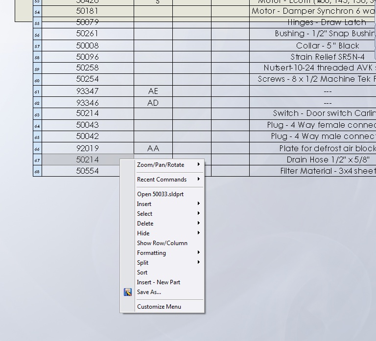

When I generate BOM from my assembly in the BOM table I see the part numbers and descriptions of some parts are not matching.
For example in the picture that I attached 50214 part number is not matching the description of Drain Hose ... but as you can see when I right click on the part number it will open the item with 50033 part name (the description for 50033 is Drain Hose).
I have never had this problem before and not sure what is wrong and I checked the properties of the parts they are all fine. it is just the BOM that does that.

Check the configuration properties of the effected file (both under File > Properties > Configuration tab AND when you right click on configuration and select properties) and make sure there is no other property defining the part number.

There is always one configuration by default. Check the properties of that in both places.

In model:
File/Properties/Configuration Specific
Check property names and numbers.
