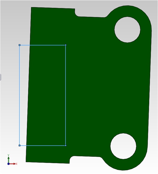

I have a part which is not aligned to its plane, however the lines have vertical and horizontal properties. How can I fix this???
When I try to sketch on a surface of the part, the sketch draws on, but does not align to, the selected surface.

More info in case it help find the solution...

Can you please check and edit the base sketch for this feature (highlighted in green). Also check which plane you have used for the base sketch. And any chance to share your file??

Was this sketch made on a plane which was defined by rotations off of the basic planes? That might explain why vertical doesn't seem to line up with the Y axis.
You might have to put a couple of perpendicular construction lines in your sketch and align one of them with one of the basic planes. Remove all of your vertical and horizontal relations and replace them with perpendicular or parallel relations. Align at least one of your edges with the truly vertical or horizontal construction lines.
Actually, you don't need to use the two initial construction lines, but I find it to be a good idea to start out every sketch that way, so that I minimize the number of external relations in the sketch. It helps when you have to change the relationship with the model.

I drew the sketch on one of the axis planes. Never figured out what was wrong. Rebuilt part from scratch :-(

I have a similar problem, I designed a part that sits at an angle, and decided I didn't like the angle. So instead of changing the angle I cut out the bottom of the part to increase the angle at the bottom. If I edit the sketch it affects the other entities of the part. So I feel the only way to fix the problem is to somehow align the whole model to a horizontal plane, or rebuild the parts from scratch.
Or I would at least like to align the prints
You can do both:
1. Update standard views
http://www.javelin-tech.com/blog/2011/04/changing-the-default-orientation-view/
2. Rotate or move the solid body
http://help.solidworks.com/2012/English/solidworks/sldworks/hidd_dve_feat_move_surf.htm
I used the Rotate/Move option and it worked perfectly, thank you very much
