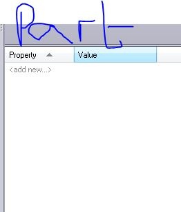

I'm using Solidworks Explorer to rename files both assemblies and parts. I can also rename from there. I am having no problems with adding properties to my assemblies but from my parts no custom properties are coming through.
Any advice?

Check and make sure they have the properties under custom tab as I think configuration properties doesn't work in SE.

Thanks for the reply.
I've checked that and it doesnt seem to be the problem here. Its not a show stopper but it would be helpful if it worked.

How are you adding the custom properties in your parts/assemblies?
Properties in the "Configuration Specific" tab wont show up in SW Explorer.
Only the ones under the custom tab.  Also if the master file that you are copying
from has the custom properties in it then so should the copy.
