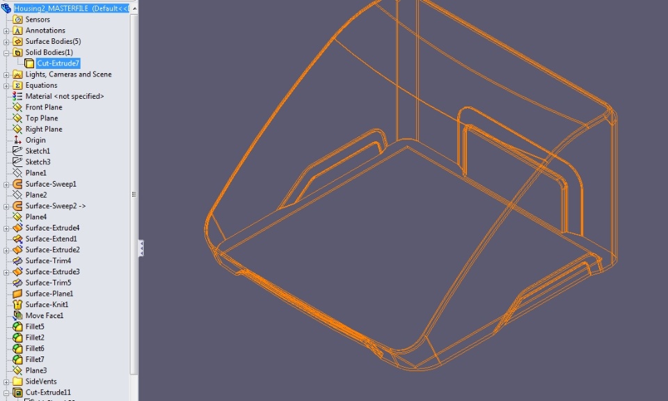

I appreciate this is a fairly old post but a user had something similar and I was hoping one of you would know if it was 'hidden tree' related.
This is what I have from him -
'Switch to part from assembly….its invisible! Run the cursor over and you get wire frame highlights…so it is there really (its just shy?). If rotated the model would re-appear, only to disappear when stationary.'

Open the Solid Bodies folder and expand the Display Pane to make sure the body has not been hidden.
Also run the SolidWorks Rx > Diagnostics tool to check the graphics compatibility

also try a control Q, it will sometimes fix issues like this.
JS
JS 2014-08-19
Also make sure the first feature in the tree isn't hidden.

User tried Cntrl-Q
Hide & Show
Editing Features
....but has recently had a machine upgrade I found out, so will check drivers etc on previous nodde and see if this is repeatable on new machine.

If it's a new machine, chances are the graphics driver is not correct.
Run the SolidWorks Rx > Diagnostics tool to check.
SF
SF 2014-08-19
That is something to watch out for....Dell install the latest drivers...which are not SW supported/approved. I am having to get them rolled back to the SW approved drivers.
