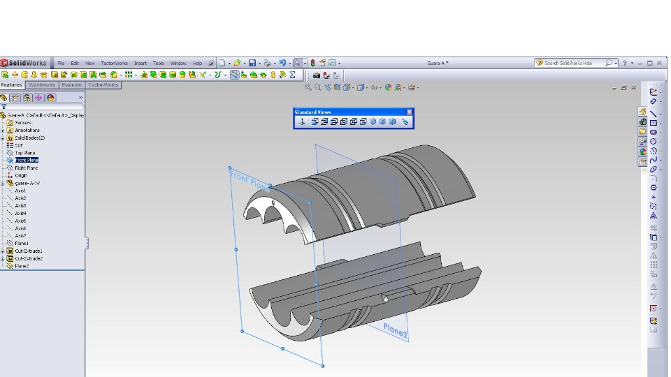

My boss sent me a 'part' and it's in an 'IGES file, .igs  (extension), he started the drawing for the part in a front plane (parent plane--in front); I wanted the parent plane to be in the center. Please see attachement.

CC 2011-01-03 Best Answer
Insert>Features>Move/Copy...
Then you can move the body to fit. Do this right after you import.
Another method is to create an assembly. Insert the part into the assembly, and orient it where you want. Then do File>Save As> and chose SolidWorks Part as the file type.

When you create your initial boss protrusion, select edit feature and change to Mid plane.
This will make your part centered on the sketch plane.

Do,
Yet another option is to make a coordinate system with the origin and orientation that you want. Export the part and pick the option to use the coordinate system you created. Import it back into SW and it will be where you want it.

TC 2011-01-08
Why not edit sketch plane?
CC
CC 2011-01-10
Tony,
Do was working with an imported part. There was no sketch, nor a sketch plane.
