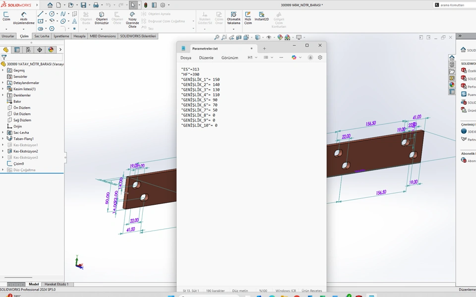

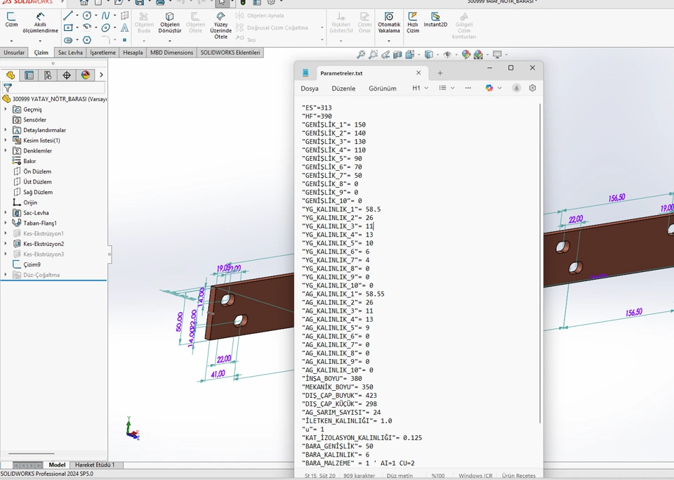

 I have an assembly whose values are taken from a text file in a windows folder, but interestingly: when I rebuild/renew the assembly, it reads the parameters from the text file but after then the most of the parameters that once were in the text file, disappears(erased)..
 And when I pack and go the assembly, the same weirdness happens..., in the target folder with new assembly, the text file won't have the most of the parameters..
What might be cause, How can I overcome? if it isnt a solidworks debug issue..

Is the txt file set to be read only, if so try since that should stop SOLIDWORKS from editing the txt file.
SA
SA 2025-07-09
Thank you for answer, seems reasonable but I dont want it to be read only since, we will want all my teammates to enter their own values to the text file then rebuild the assembly for their own values, and do the same for their next projects on..
