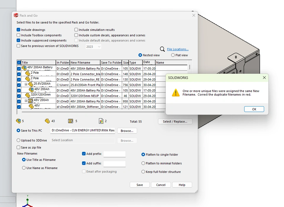

I am facing a problem in solidworks pack and go feature, there is always showing a error "one or more component assigned with same name" but in the tree items there is not showing any component with the same name with red.
还原打开装配体后在试一下
This may be an early software BUG,SPR1236817 # Pack and Go from SOLIDWORKS shows warning 'One or more unique files were assigned the same new filename. Correct the duplicate file name in red.' but no files are highlighted. F.O. 1231828
It has been fixed in version 2022SP4. It is recommended to upgrade the software directly to version 2022SP5 to test if the problem has been resolved.
