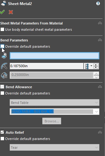

I am trying to make several changes to  a sheet metal part including using a bend table with different thicknesses in different configurations but i can't seem to get past the first step of overriding the default bend parameters in order to allow the thickness to be configured.
I have ended up with basically exactly the same code as here:  (basically just the name of the sheet metal feature itself is different)
   2019 SOLIDWORKS API Help - Set Override Option for Auto Relief Default Parameters Example (VBA)
All the code seems to work fine, the sheet metal feature is selected, I can read the different override status' for each but setting the bend parameter override does nothing.
Has anyone successfully implemented this particular api tool, is there something I am missing?
