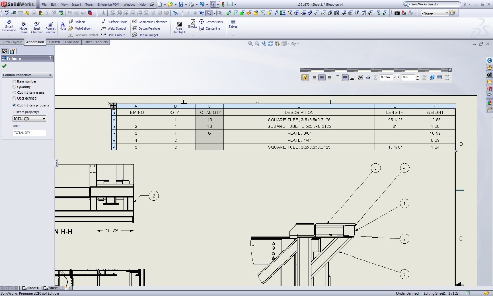

Hey Ryan, I am fabricating subrames for trucks. I have modeled one subframe, but the same subframe is going on 13 identical trucks. We are sending the channel and tubing out to be cut so I want to send a single cutlist for 13 trucks. So I want my cut lsit to show the quantity for 13 trucks, not one truck.
Ok, I figured as much. What you can do is create a Custom Property in your cut list properties like Total QTY or something like that. You will have to manually enter how many are needed for all 13 subframes. Then add another column to your cut list and link it to your new custom property (see picture). This is the best way I know of achieving what you are after.
Ryan W.
Hey thanks, I just figured it out before I read yours. I just inserted a new column named QUANTITY and hid the default QTY. Column. Thanks again
