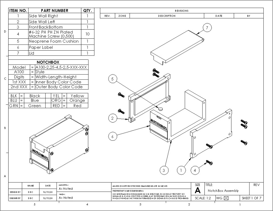

Hi Eddy,
The new series....
Welcome to Design Talk - Notchbox. This is the first of a new series where I will present product designs that I have created from scratch, or ones based on products I have seen in the world at large and find interesting or inspirational.
Link to free to watch video: https://www.youtube.com/watch?v=_Ym4iwV6018

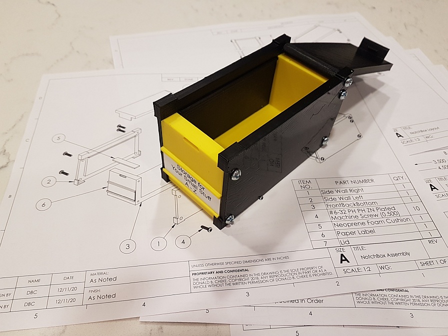

DC
DC 2021-03-26
Here are a couple renders I made for the upcoming presentation. Modeled in SolidWorks, rendered in KeyShot. I can post a link here to the presentation, if you would like, when it is complete.
comment imagecomment imagecomment imagecomment image
