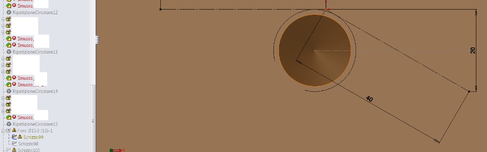

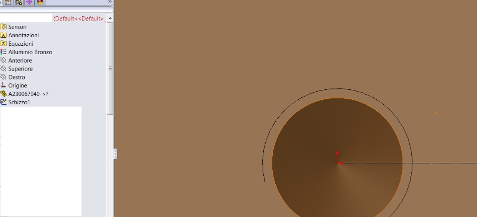

This is the only sketch whose origin did not move (and where all sketches should have their origins).

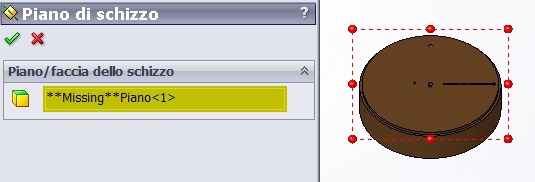

Example of lose reference (it should be referred to top face, but it is missing and labeled as **Missing**Plane<1> instead of **Missing**Face<1> )

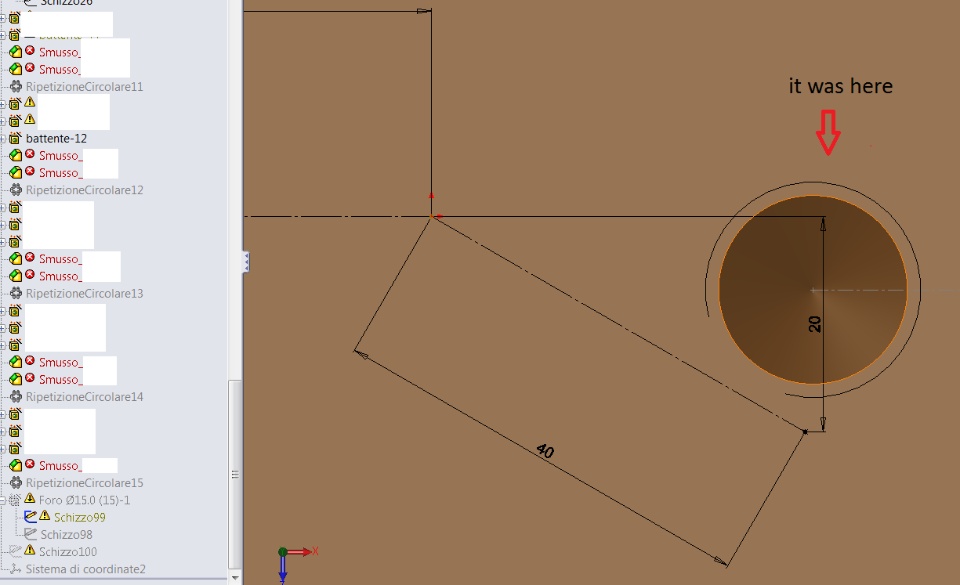

Example of moved origin (I changed its reference plane to top face)
