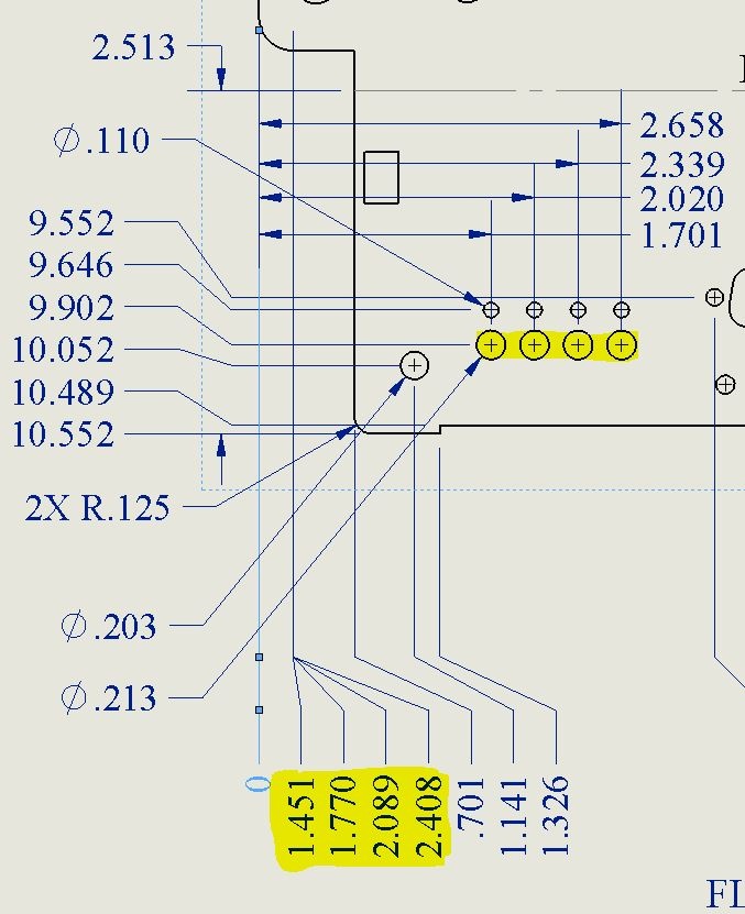

Ordinate dimensions are misplaced and show wrong value when updating flat pattern.
     When updating a flat pattern with new ordinate dimensions using "Add to Ordinate", the new dimensions all stack up in one random place and give random values.  See attached.  When selecting the highlighted four holes (added during revision) we get the highlighted dimensions.  Each value is off by .25" in this case and they all point to the same featureless random point (about .25 off of zero in this case).  Starting a new ordinate series works as it should sometimes, other times we have to create a new flat pattern view and re-detail.  Adding linear dimensions worked in this case, sometimes even they are wrong.  The holes were added by editing an existing sketch/cut feature.  Ctrl+Q only changes the suspect dims to dangling.  This is reoccurring and happens on multiple PCs with multiple sheet metal parts.  Any help or work-around ideas would be appreciated.  SW2016 SP4.0 & SP5.0

How was the flat pattern view created?  Was the view rotated?  If so, what method was used to rotate the view.  While I am not saying this is a solution, I have seen rotated views mess up zero line dimension.  If possible, please post model and drawing.

CM 2016-11-30
The view was created by hotkey, but would be equivalent to... insert / drawing view / Model.. / then under more views (A) Flat Pattern was selected.  The view has not been rotated but it has been flipped in this instance to show some countersink holes.  Interesting to note that when the view is created via View Palette, the flat pattern comes in rotated 90° CW relative to the original view.

SA 2016-11-30
I have seen the orientation be different depending on how the flat view was created.  Have you tried inserting the flat view into a new drawing format?  Occasionally,  drawing have issues and do not create the views correctly.  After doing this, do holes dimension correctly.  Another thing you might try is, go to the flat pattern configuration and suppress the Flat-Pattern feature so the part folds.  Follow that by unsuppressing the Flat-Pattern feature.  Go to your drawing, are the holes dimensioned correctly now?

CM 2016-11-30
If the view is recreated, in any way, it works fine.  Sometimes, just starting a new ordinate dimension string in the same view works fine too.  Suppress cycle doesn't work.  I'm starting to think it has to do with what feature was selected for the zero.  Another note, the horizontal ordinate and both vertical ordinate dimension strings can be added to as expected.

CM 2016-11-30
If I re-attach the zero endpoint to a different feature, changing the zero reference, it updates correctly.  That solved it.  At least in this case, hopefully it does next time too.
