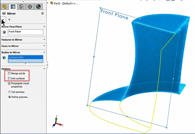

In this video Merge solids and Knit Surfaces options are unchecked. I tried with checking these options, result is okay.
What is the reason these options are unchecked.

Merge solids is used for merging two solid bodies into one body. This would have no effect when used with surface bodies.
Similarly Knit surface is used for merging two surface bodies into one body. This would have no effect when used with solid bodies.

First explanation is okay understood. But second one is in question, because it is two surfaces but Knit Surfaces option is unchecked.

Yes if knit surfaces is unchecked then two surface bodies would be produced after mirror instead of one.

Is Merge solids & Knit Surfaces function same only thing name different? Both are making bodies one.

Both have same function but they are different since once is used for solid bodies while other is for surface bodies.

To answer the question as to why they are unchecked, after watching the video in which I was waiting to see if something was going to be added to the mirrored surface (which it wasn't) there was no reason to leave them unchecked. What it does show is there's more than one way to get the same job done. Some shorter than others.
