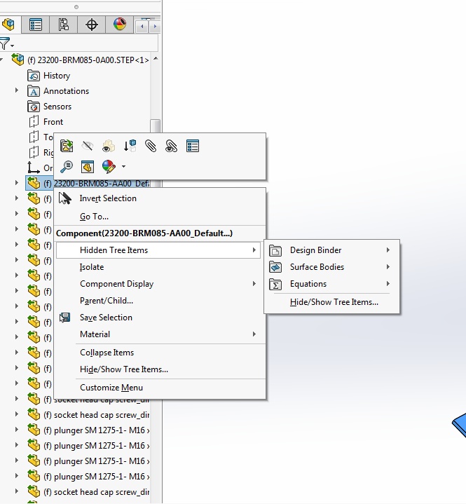

I open a assembly file with step format .
When open file I can not access  the part in feature design tree
How can I fix this problem .

DM 2021-04-08 Best Answer
Right click on the top level in the feature tree and select dissolve feature:
This will break the link to the original STEP file and should allow you to open the 3D sub parts.
comment imagecomment image
TT
TT 2021-04-08
You can switch off "3D Interconnect" and will not have that issue in the future.
Or you can do it as ‌ suggested.
