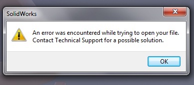

Recently, update to SW2011. for some project, after few days running(use SW2011 open sw2010, and save), then open some main asm file shows following error,
it's so serious problem, it's affected our two projects, we need to re-do asm.  Anybody can help to solution?

Have you renamed any parts or sub-assemblies lately?  I had a similar problem after switching to SW2011 and it was related to renaming and the reusing model names without opening the assembly and rebuilding.  The models were renamed with SW rename, but there were still issues.

It almost looks like your files is corrupted.  Do any of your
machines still have 2010 on them?  To see if it still loads
on that machine.
You might want to contact your VAR and submit the file to them to see
if they have any issues opening it.
Also if you try running the Solidworks Rx tool and send them that file that may
tell them something about the file as well.
Start>all programs>solidworks directory>solidworks tools>solidworks rx

I'm not sure whether to do rename or reuse something, but absolutly to save all of this assembly before I close it even like this do.
I think it maybe a bug in SW.

I've uninstalled SW2010 version and deleted all old relation folders(even in hided folder), then install a fresh SW2011 version,
I do think that it's necessary to do Rx record, because the error just come out  before opening the asm file.
but i also sent this error to Solidworks side for study, still no answer yet.

I would still do the Rx.  That file can tell a lot.  Once you have the file send it to Solidworks.

Was there ever any solution to this problem?
If so, please share. We are having the same issue, and it appears to be pretty common on other forums also.
