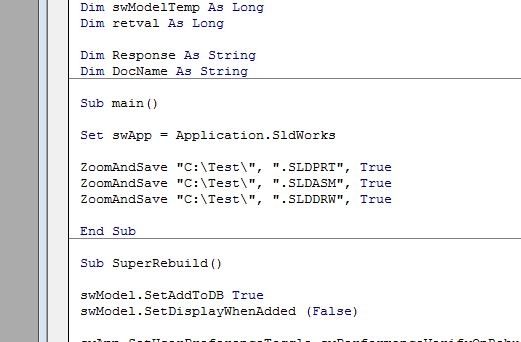

You may use this macro Zoom and Rebuild
OR
You need to create SolidWorks Macro Template to use in  task scheduler (Search for SolidWorks Macro Template under task scheduler help files)

Manually found it on the website.  Now, how do you use it?  I can see the custom task in the task scheduler, but how do you point it to a specific folder?
MC
MC 2010-11-09
Well I am having no luck....
I am a "real novice" when it comes to this kind of stuff.  Seems as though the macro file has a lot of pointless characters in it when I try to view it in notepad.

You just need to edit the macro as change the file location. And then finally run it though SW (no need to use task scheduler).
Extract the macro to a known location. Then check these linkf for how to
Edit a Macro
Run a Macro
And if you need to go via task scheduler route, you need to create a SolidWorks Macro Template

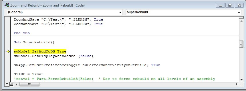

I am starting to get it now.....
But when I run it, I get this....
DG
DG 2010-11-10
Good to know that you're getting into it.
Now to fix this issue, edit your macro (using the method I stated above) and go to Tools > References. Now uncheck any missing library and select the corresponding one for the SW version you have. Click OK to apply the changes and then click on Save to save the settings. Run the macro again (make sure you have changed the file location)

I think that I am close.....
Is this where you change the folder location??  Capture
And with these check marks it still errors out.   Capture2
Here is the error.  Capture3
Will this macro work as is with 2010?  Or does it need modified?

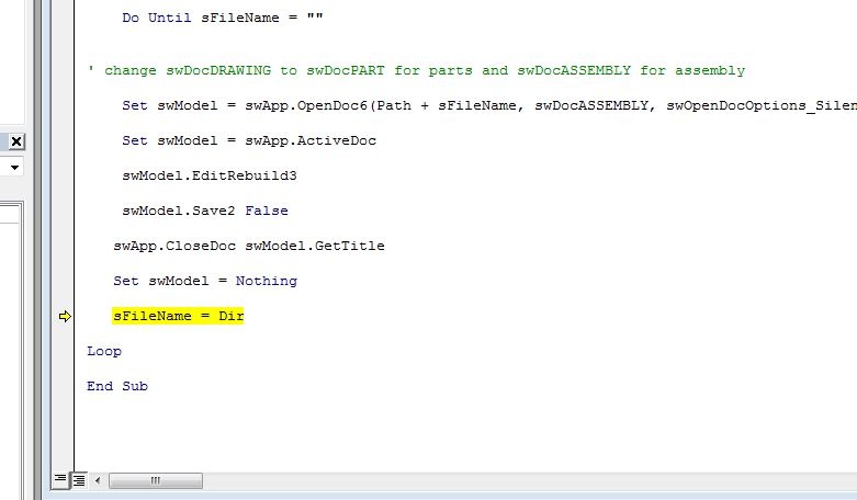

Don't know why that is not working. Try the attached one, just extract and run.
Currently the macro works for SW Drawings. Change the codes for parts or assemblies. And no need to set the folder/file location in the macro, just use browse option.
MC
MC 2010-11-10
Works like a champ!!  Thanks a million.

For some odd reason - the macro is erroring out after opeing precisely 128 files....
Duplicated it on 2 completely different folders.
Thoughts???

It can be because of the system resources. Not sure how to fix it or how about doing the files in order of 100 files per run.

I just did another folder and it stops at exactly 128 files.
My system resources were fine during the process.  Is there maybe a "ticker" or "counter" that is getting tripped and ending the process??
I added the error captures.

I have never updated that much number of files so not sure of reason for the error but here is the one with counter. It'll stop at 100 files

Ok, spoke too soon. One last request.
Can you add the follwoing to the macro as well?
Dim swApp As Object
Dim swPart As SldWorks.ModelDoc2
Const PicPath As String = "\\SW_Settings\Macros\background.tif"
Sub main()
Set swPart = swApp.ActiveDoc
If swPart.SceneBkgImageFileName = "" Then
    swPart.InsertBkgImage PicPath
Else
    swPart.DeleteBkgImage
End If
End Sub
Thanks again.
R.

Can you put that picture to test the macro
SF
SF 2010-12-17
see attached.
Thanks
DG
DG 2010-12-17
Just add these lines above swModel.EditRebuild3 in the macro.
