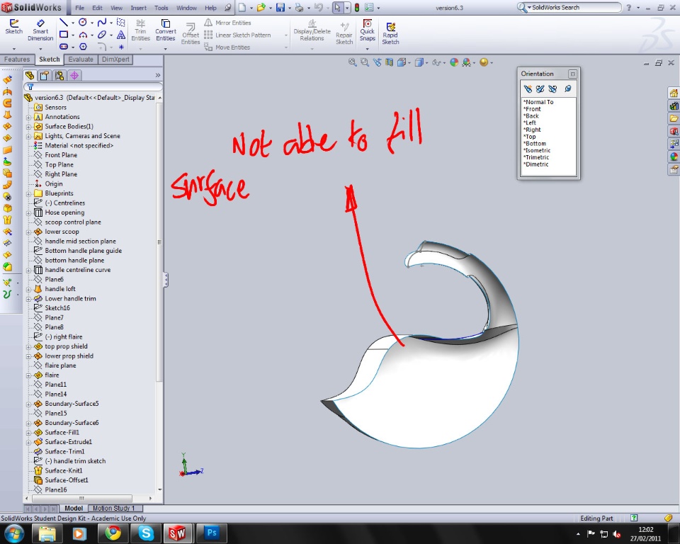

Ok, got some problems with this model, open surfaces. Trying to create a solid
Hi, I'm trying to create a fill surface to create a solid shape from these surfaces. I then want to shell it to make a plastic part, add ribs etc.
I am having a load of problems, but the main ones are coming from not being able to fill the surfaces. I am doing a check and it is saying that there are a few open surfaces, but I have no idea how to fix them. I believe that the problem is coming from the offset surface.
How do I fix these errors?
Any help would be fantastic.
Thanks, Will.

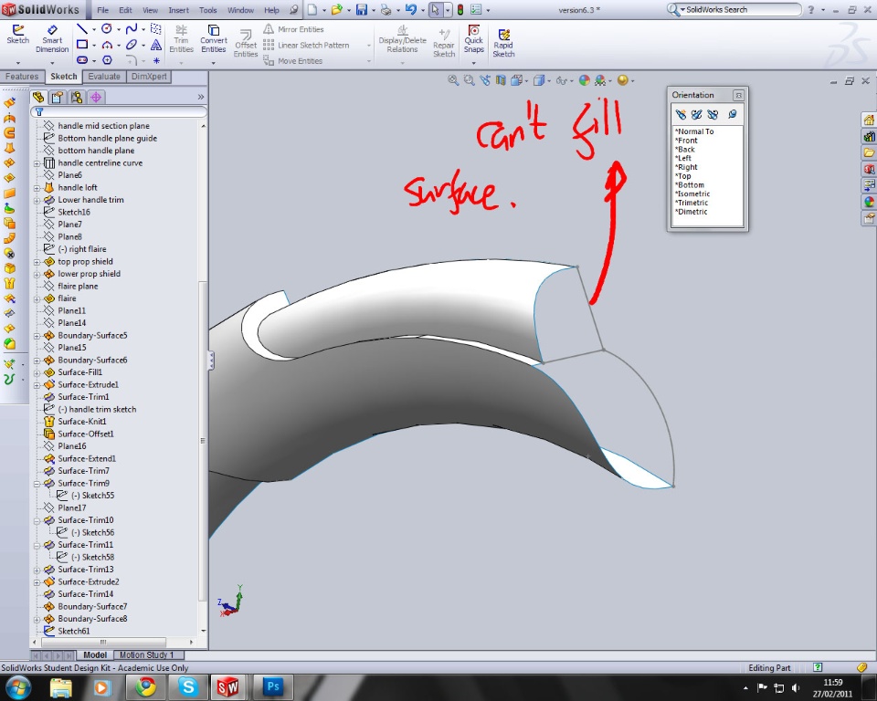

I've been trying it another way, but again it is causing me issues. I am getting errors saying "open surface" I think that this is what is giving me errors. Any advise how i could proceed

Maybe you could delete face and replace.

Extrude sketch 61 to "cap" the area you want to fill. I noticed that your handle surface does not come in tangent to your mirror plane.  First, of go back to your "Handle Loft" feature and assign "normal to profile" for your upper guide curve. Now you can mutual trim, create a mirror plane planar cap surface, mutual trim, make solid. (see attached.)

I was thinking about this problem for the whole time that I was at work, got home and checked the loft, had a bit of a fiddle and it worked!! I actually did a dance
Then noticed your post and you explained why it wasn't working. Thank you so much. This project is driving me nuts and I am so greatful for people like you taking the time to have a look at this problem and sorting it for me.
