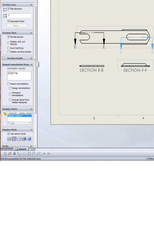

     I wanted to do a section like cut through the plan to show more or less a front view, but then jog down to show something else at a different depth of the part in the same orthographic section. I tried the aligned section, but I don't want the extra portions, like when the section line goes 90 degrees, and that. Just the direct flip at the two depths. Does any one know how to do that in SW?

the simple way is to sketch the setchion line first and then (with a sketch segment highlighted) hit the (standard) section tool.
if you already have a standard section, you can right click on the section line and choose edit sketch.

Is this what you are talking about?

Thanks, Jeremy; that did the trick.
