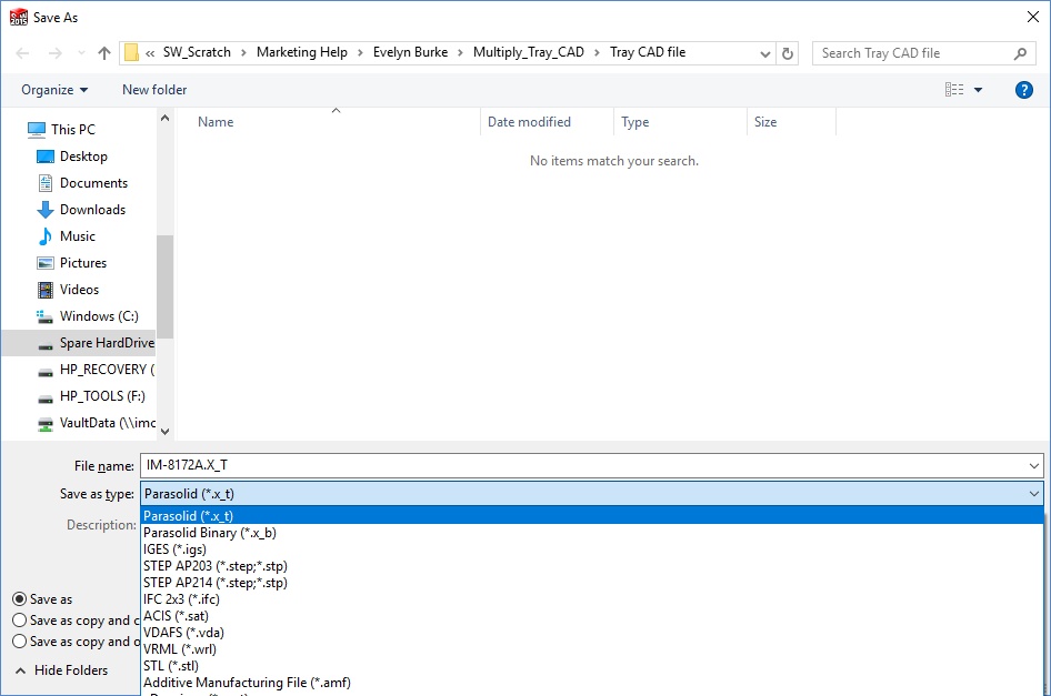

odd assembly issue with one assembly in SW2015
SO, have an assembly with a few parts in it, has an odd symbol at the top of the assembly feature manager as shown below.  When I try to save the assembly, it does not want to save as a SolidWorks assembly.  It defaults to Parasolid, and has all other options except SolidWorks.
All parts have history features and can be edited, BUT NOT in the assembly, need to open them individually, then can work on them.  I cannot constrain them, cannot drag them around etc.  Not sure what the symbol is at the top of the assembly feature manager, prior to it's name.  Have not see this before, so curious what is going on.

DG 2017-01-27 Best Answer
That seems like a future version file icon.

At some point SOLIDWORKS gave Backwards compatibility mode in 2013 but it was taken off due to some issues. And then it was back with 2015 SP 5.0 / 2016
How to Open SOLIDWORKS 2016 Files in SOLIDWORKS 2015
Ans here is a 2017 file opened up in 2016

So after digging further it is a future version as Deepak noted, however, what was really goofing up was that the part was still in SW2015 which we are currently using, only the assembly was saved in SW2016....go figure
anyway,, Thanks for the help, may have recognized it sooner if it was shown as clear as Deepak's snapshot.
