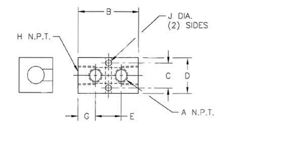

NPT 1/4 internal thread
Hello, my friend and I are attempting to model a manifold and it specifies a threading on two holes. We're unsure on how to go about it. We both attempted the hole wizard and thread feature but to no avail. The internal thread is based off of the attached print with H = 1/4 and A= 1/8. We've referenced the machinist handbook and other threads/websites but can't seem to accomplish this task.
Any help would be much appreciated.
Edit:: I selected the correct answer for the option I used but there was a way to model, directly, the threads I was looking for, offered by Vladimir Urazhdin below.
Another resource for making threads would be to take a look at McMaster-Carr they have 2D prints and 3D models of nearly all their parts. I was able to find my specific part and see how they approached the model. Below you'll find the finished part I made.

Cosmetic threads, used tapered pipe tap. For actual threads in your model you will need to create a helical feature using constant pitch variable diameter. and do a sweep cut.
Whichever option you need, you can do. The cut threads is obviously a little more difficult.

Unfortunately the Thread feature doesn't include N.P.T. threads as yet.
I'm hopeful that they will be included in a future release.
In the meantime I think Paul Risley hit the nail on the head.

Create 1/4" NPT male (as master part) and use Combine Feature to create Female Thread. See:

Sure, we ended up going with the cosmetic thread option with a tapered pipe tap, just as Paul Risley suggested.

As far as manufacture goes, does having cosmetic threads as opposed to actual threads modeled make any significant difference?

The only way I can see that having cosmetic threads would matter would be if you were going to have your part 3D printed.
PR
PR 2017-07-18
Graham since you are making a basic 2 port manifold cosmetic threads will not affect the build of it unless you are 3d printing the part.
I would have to look for sure, but if you are 3d printing the minor diameter taper should allow for pipe tapping on a 3d printed part. Could be wrong it has happened before.
