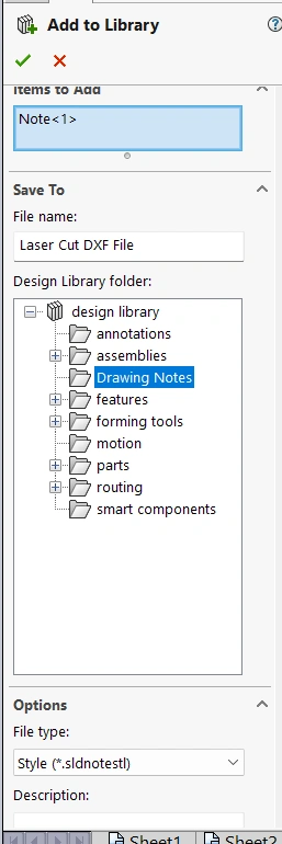

Create a note

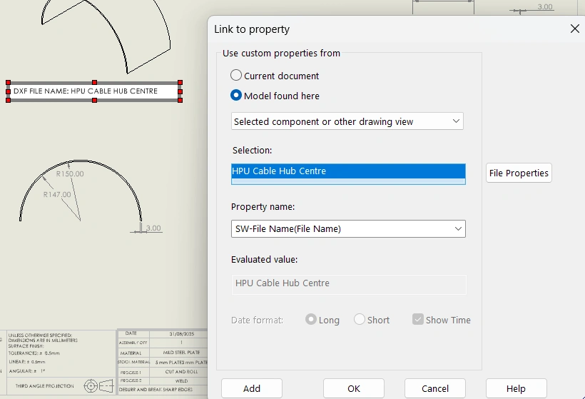

Link to property
Click OK
Exit note
Right Click Note / Add to Library
Save
Now when I drag the note from the Design Library to a sheet component view. The expectation was that it would update to the component view properties. but No
What have I missed?

Hi Colin, just double checking with the note that has been brought to the design library, its property is linked previously to a custom selected component in the drawing view. When you insert it into a new sheet, I presume it looses that link that you chose in the selection box when choosing the property?
JS
JS 2025-09-01
What you want to use in the note is $PRPSHEET:"SW-File Name".  It maybe set to $PRP:"SW-File Name"
JS
JS 2025-09-01
You may even want to go with $PRPVIEW:"SW-File Name", because your image does not show any of the views in focus.  If the note ends up on the Sheet instead of a view, all it will show is $PRPVIEW:{SW-File Name}, and you will know it is not on a view.
DM
DM 2025-09-02
Right click note and pick attach and choose view.  That or delete and bring it in again and drop it on the middle of the views then move to final location.
