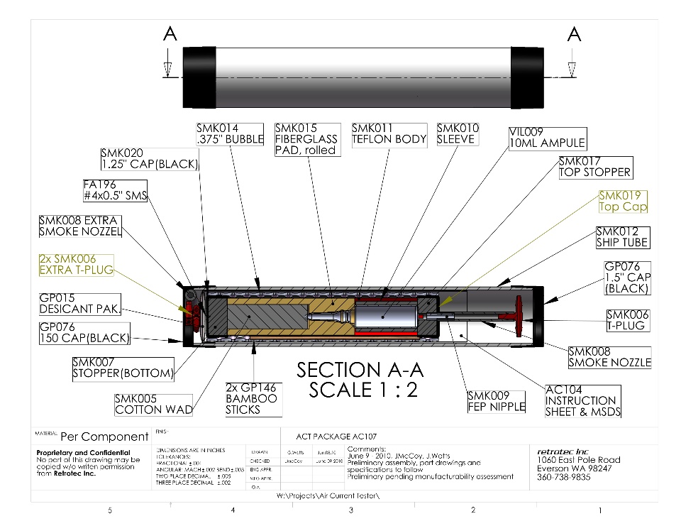

We are still using SW'07.  I have a drawing, and my engineer has another, where some of the notes we've added to the drawing apear black as they ought and others apear brown (or something).  See attached jpg, see note on left side "2x SMK006..." and note on right side "SMK019 Top Cap".
Haven't found any clues from properties as to why this may be, suspect some linking error maybe.  Anyone know what's going on?

I would check layers, leader attachment (pull it off the part and put it back), does recreate the note work?  I have noticed some old drawings have items that I can't change the color of no matter what I do except recreate it with the right properties.

re-attach the arrow to the part it is pointing to, should resolve the color.

Jerry,
What you are seeing is what is called a dangling aspect which means in your case the leader
has lost its connection.

Thanks guys, problem resolved!
